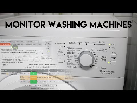

Use-cases
I'm using this plugin to monitoring my washing machine:
